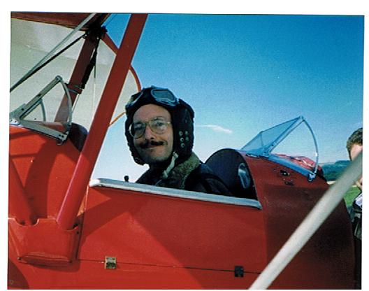

This kind of thing was certainly not unknown in the past when aircraft needed their props swung. But the view would have been that someone had cocked up. At least, the intending pilot should never have swung the prop himself - he should have been in the cockpit and got someone else to swing it. And unless the aircraft was perfectly trimmed, it wouldn't have got very far if it did clear the trees. James McCudden's flying career very nearly came to an end on his first day as an 18 year-old Air Mechanic in 1913 - he idly turned a propellor; the engine burst into life, and the aircraft trundled forward into another. He only avoided being sent back to the Royal Engineers because it was his first day. Aircraft often had one of the ignition (magneto) switches mounted on the outside of the cockpit so that ground crew could quickly shut off the engine of a runaway. This can be seen on these picture of William Robinson's BE2c, and a Tiger Moth (in the latter, it is under the corner of the windscreen of the rear cockpit).
