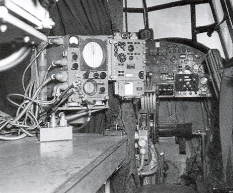

Wireless Operator Caption: H2S position in the Lancaster. Top left is the curtain which shuts out light; to the right is the flight engineer's position, with his seat folded up.

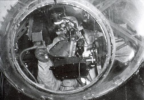

Mid-Upper Gunner Caption: The mid-upper turret, showing the fairing which prevented the gunner from damaging his own aircraft.
